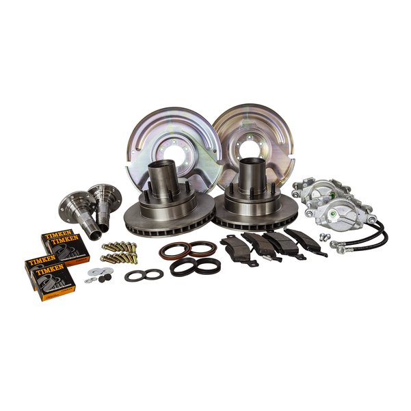

Front Disc Brake Conversion Kit | Dana 30 & Dana 44 | 66-75 Ford Bronco
Upgrade your 66-75 Ford Bronco with our Front Disc Brake Kit! Better stopping power, and easy to install. Fits Dana 30 & 44. All new parts - NO core charges!
Option#3:
Switch out to a 5 bolt James Duff knuckle setup and disc brake setup for a Ford. They sell this all in one kit. There knuckles are not stock as they are heavy duty. Seems like a good setup.
https://dufftuff.com/product/ft-dis...-bronco/?attribute_choose-caliper-type=T-Bird
If you have any comments that would be helpful. A few questions as i am no expert;
A. can one switch from a 6 bolt knuckle to a 5 bolt if your bronco is a 6 bolt? Am i missing something that would also be required to be changed or is it even possible?
B. Is the Ford brake setup or GM setup better? I have the hydroboost setup under the hood.
